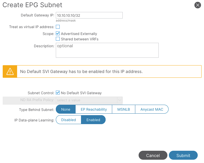

I remember there being a change in the way subnets are handled in ACI v5.x - but can't find the relevant release note. But to focus on your problem I'd like to know that you have:
  • defined each of the 4 servers with /32 IPs under the EPG Subnet
  • with the [x] Advertise Externally option selected and
  • the [  ] No Default SVI Gateway option unchecked
Then verify of the EXTERNAL router that you are receiving all four /32 routes
