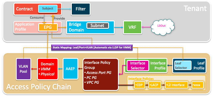

Hi @Nitesh_A ,
Let's do this in pictures.  Here's a generalised tenant construct:
The L3 part of your design is defined either in a BD or an EPG, but (most importantly) viewed via the related VRF.  The picture above is probably way more complicated than we need, but you'll notice that there are no PHYSICAL PORTS in the picture, and that's because it is just a MODEL - if I define those objects in ACI they exist ONLY as a model on the APIC, no switch knows anything about this model (YET)
Here's a generalised Access Policy Chain:
Here, the physical ports are defined by the Access Port Selector and assigned a set of policies via the Interface Policy Group - my illustration shows only Access Port Policy Groups and a Port Channel Interface Policy Group - but it is likely to also have VPC Interface Policy Groups
Most Importantly, this policy group is allocated a set of permitted VLAN IDs by virtue of the fact that the Interface Policy Grouplinks to an AAEP which links to a Physical Domain which links to a VLAN Pool which defines a set of VLAN ID THAT CAN BE USED ON THOSE LINKED PHYSICAL PORTS.
NOTE: The VLAN Pool is a collection of VLAN IDs that will be used to classify traffic into EPGs. It has NOTHING TO DO WITH Layer2. I suspect this is a flaw in your thinking when I read
Physical domain consist of VLANs and EPG consist of BD which contains subnets. So defining both Physical Domain & Application EPG's means we are linking L2 that is (vlan) & its respective L3(subnet) together here under AAEP ?
So to answer that question - NO this does NOT mean we are linking L2 VLANs (because the VLAN Pool and Physical Domain have nothing to do wth L2) & its respective L3(subnet) together here under AAEP.
Linking of L2 and L3 happens at the Bridge Domain (even if the subnet is defined on the EPG) and the related VRF.
Now, to complete my pictorial journey, let me finish by saying that the two models above are just models as they stand. There are two very crucial pieces missing.
  1. The EPG needs to be connected to the Physical Domain - this is configured under the EPG. The moment an EPG is linked to a Physical Domain, all the Physical Ports and VLAN ID that appear in that chain are available for use by the EPG, but are not able to be used until step 2.
    [Sidenote: If the Domain was a VMM Domain instead of a physical Domain, step 2 would happen automatically]
  2. At least one port and VLAN ID must be assigned to the EPG. This can be done two ways
    1. Mapping Down (as discussed earlier)
    2. Mapping UP (as discussed earleir)
Here's one last picture (that took me over a week to draw in 2015 when I was trying to get my head around this stuff)
RedNectar aka Chris Welsh.
