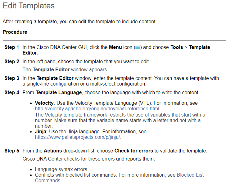

While working with the template editor on DNAC 2.1.2.x and reading through the documentation I have found information which I believe is incorrect. When you create a configuration template in DNAC you have to specify the template language, after which once the template is created it cannot be changed (when you click on template properties the language option is greyed out). However the documentation in step 4 says otherwise.
In addition, in step 5 the action menu does not have a Check for errors option to validate de template, I have used the template simulation and deliberately enter wrong commands but the simulator did not complain.
 I am curious how can I run a validation check on a configuration template, does anyone knows?
TIA
leandrordc
The check is done when you save template.
