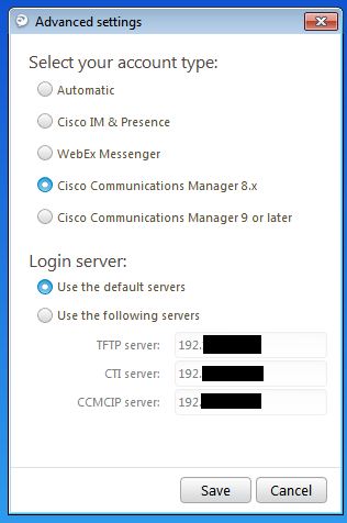

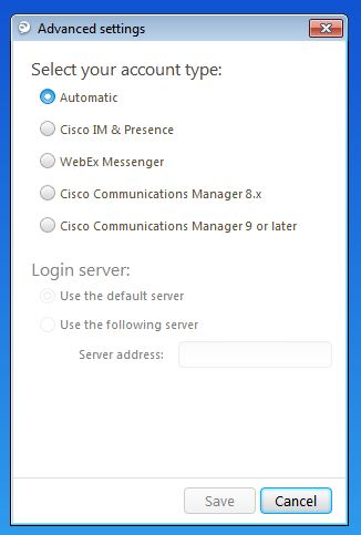

This installs fine, however when you launch the client and open the advanced settings it defaults to "Automatic" account type however
I need this to be set on Ciscio Communications Manager 8.x
If you switch the mode manually it does have the correct TFTP, CTI and CCMCIP servers set in the config:
