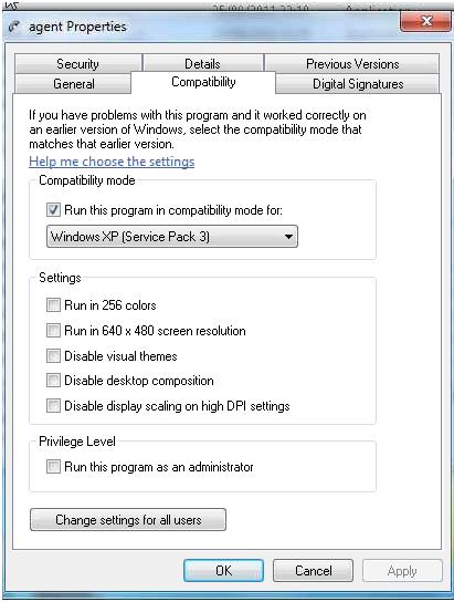

CAD should be installed on 64 bit OS as a 32 bit computability application.
please right-click on cad setup program  and choose the "Compatibility" tab of the
properties page.   Check the box that says "Run this programin compatibility mode for:"
and choose
"Windows XP Service Pack 3"
Then try running the program again.
