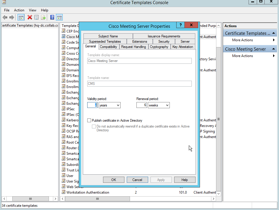

Start the Certification Authority console, select Certificate Template. Right-click the Certificate Template and select Manage.
Duplicate the Web Server template and configure the duplicate template to allow server and client authentication.
 On the Certificate Console, issue a new certificate template named CMS.

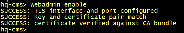

 Enabling the Web Admin Service
By default, Web Admin listens on HTTPS port of 443. However, we will enable the Web Bridge for conference users and this service will be available on the default HTTPS port 443. To enable both services to co-exist, we will configure Web Admin to listen on port 445.
On HQ-CMS, specify the interface and HTTPS port 445 for the web interface.
 For the certificate to be used, specify the certificate cmscert created in previously with the relevant key.
 Finally activate the web admin service.
