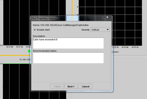

Right-click on the CallsActive window and click the ‘Set Alerts/Properties’ button.
Type in the description that you would like and set the severity. Click Next.

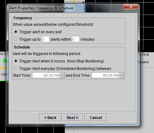

Choose the Value Over/Under and put in the value that you would like to set the limit as.
Click Next.
You can choose to set when the alert will be triggered.

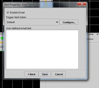

If you have email set up already, then you can configure this as well. Set the mail text that needs to be displayed. Click configure to set a new email address.
Click Save after you’re done.
