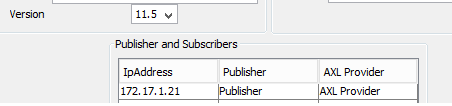

Hi Graham,
Yes, it does show our Publisher IP address in line 1 and our Subscriber node in line 2. Attached is a screenshot of the line for the Publisher. You can also see the version information is set to 11.5.
Additionally, I have browsed to https://10.16.133.200:8443/axl/ on the AQM server and was able to successfully validate the server is working and accepting requests. The credentials I entered are the same ones I have in the configuration. See second screenshot "AXL-Working".
