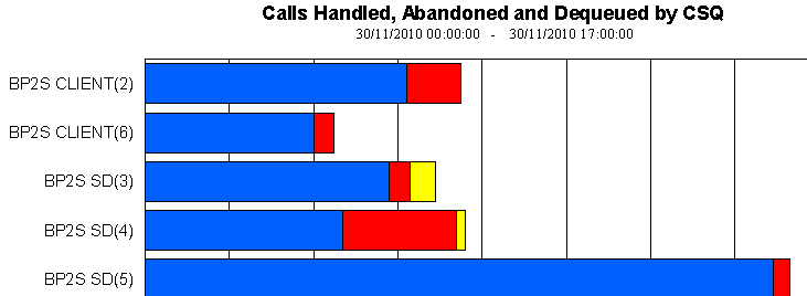

I have a 2 scripts each with a different CTI RP. Script 1 is CSQ1 and Script 2 is for CSQ2. We have the same agents who are assigned to both skillsets. They log in under a single Agent ID. However when I run reports now we see multiple instances of the same CSQ1-see CSQ REPORT.  If I remove the CSQ2 from the agents so they only have a single Skillset  CSQ1 , we then run reports I only see the single CSQ -see attached SINGLE CSQ.
Is this normal?The script are two separate scripts using the same resource CSQ

This is normal behavior. When the agent receives call in CSQ_1, it will show up as "busy_other" or equivalent in CSQ_2.
Thanks for the  quick reply. I`ve attached a clearer example of the multiple CSQ report
What does the number in brackets mean next to each CSQ- is it just for reference
Why multiple isntance of the same CSQ though ?
