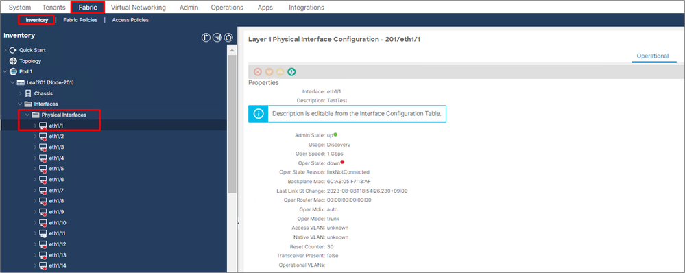

In versions 5.2(7), 6.0(1) and later, it is no longer possible to change the Interface description from Fabric > Inventory, and a message appears on the Interface Configuration screen indicating that the configuration point has been changed.
Clicking Action > Edit Interface Configuration from the Interface Configuration screen will display a screen for changing the description, but if migration has not yet been performed, a message will appear alerting the user that migration will be performed if the settings are changed.
If you do not want to migrate, and would like to keep the previous configuration method, change the description of the Override policy.
(The description set from Fabric > Inventory was actually reflected in the Override policy and applied to the interface.)
