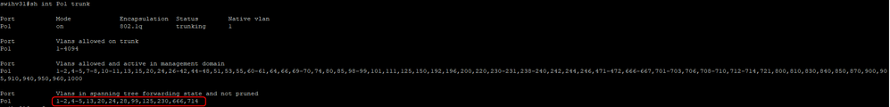

I have issues with my VLAN 200 on 1 of my 2 switch, they are configured as client VTP and get the same VLAN from my Backbone switch. These two switch has almost same configuration (swihv33 has just more VLAN allowed than swihv31).
So i have extract some configuration and made a schema of the topology (photo below).
On my switch swihv33 the vlan 200 works fine and i can get an IP from my DHCP for example but i get nothing on my switch swihv31. The only thing that i noticed in spanning-tree configuration that is one (swihv31) is with Desg role on the interface Po1 and the other one (swihv33) is with Root role on interface Po1 :
Any idea, why it works on 1 and not on the other ?
Regards

Thanks for answering, actually for example i don't get any IP from DHCP on the vlan 200 on the switch swihv31 but i get one correctly on the switch swihv33. They have same configuration and they discover vlan 200 correctly from the VTP Server.

And yesterday i noticed that my vlan 200 was pruned on my switch swihv31 :
So i launched the command switchport trunk pruning vlan remove 200 on my interface Po1 on swihv31. My vlan 200 is no more pruned but it still doesn't passthroug the trunk.
