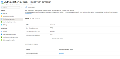

What's "MFA Registration policy"? I see "Registration Campaign" in Entra and I have this set to disabled. Is that correct or is there some other setting I should be looking for?

Yes, the Identity Protection - "Multifactor authentication registration policy"
Make sure that you exclude your Duo Users group. I would keep this on for all users as it applies to MFA for guest accounts, e.g., Sharing through SharepointOnline or Teams. unless guest accounts are also authenticated through Duo, which is not the case in our environments.

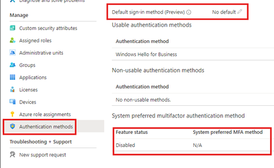

For any problem users (ideally ALL users) make sure any MFA method registered in Entra ID is removed, other than Windows Hello, if that is enabled for device sign-on via an Intune or other policy. We found that even if you exclude users from the System-Preferred policy, if a Native Entra ID MFA method is registered there may still be a system preferred method under "default sign-in method" set on their account until the method is removed. This was not consistent behavior for all accounts, but cleaning up the information on the accounts has seemed to work well, and also just a good best practice. If you have Windows Hello enabled it is likely that users were forced to register an MS Authenticator to manage at some point. EAM cleans this process up.

Example Authentication Methods from working user account in Entra ID:

Here's one of the problem users and sure enough they did enroll in microsoft authenticator at some point but it shows disabled now. I see it defaults to SMS which is also disabled but it doesn't allow me to change to no-default. I fear this user will have problems again if we enable DUO EAM.
DarkLordTyler
For the "no-default" to be set, you have to delete the methods set on the account. This includes deleting any methods that show as disabled. If they are already using the legacy Duo integration, that shouldn't be an issue, but obviously, proceed with caution.
Once you delete those, the primary field on their account should be updated; at least, it has for us.
I don't know of a way to purge all these from accounts in bulk, but I guess that this is the issue you are facing if all the other settings are correct and some users are not having issues.

I did go back and remove the default method from my test user as @DarkLordTyler recommended above. I had to switch to the 'old' view and remove the phone number from the account. When I switched back to the 'new' view, it was set to 'no-default'.  I also exempted my EAM group from our existing SMS and Phone Call method policies (we use these for contractor accounts) and the CA policy setup to use the legacy DUO config.
