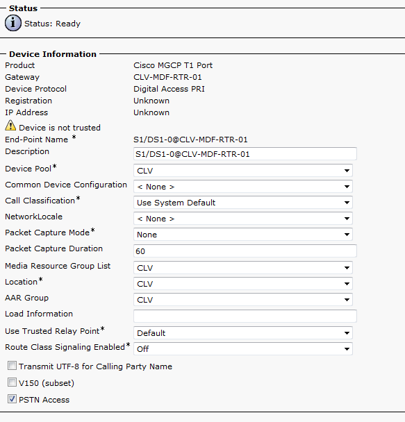

I've attached screenshots of the gateway when it was configured for MGCP
