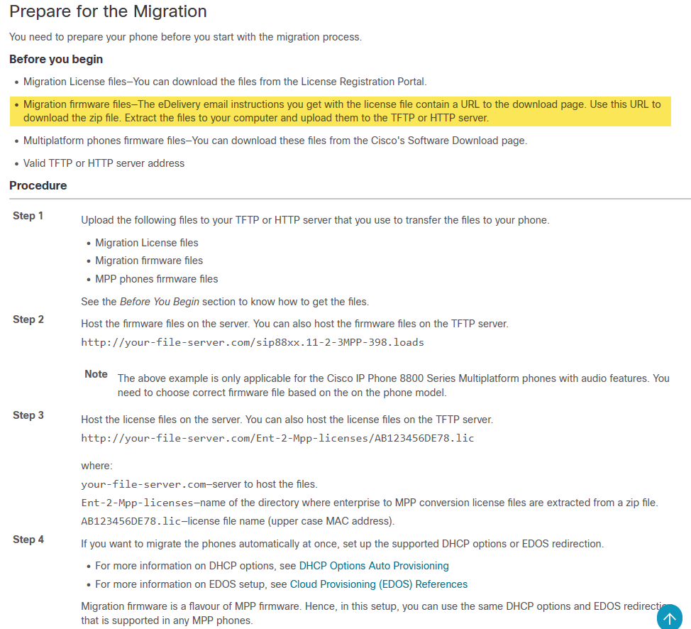

how to convert 7800 enterprise to MPP for MS teams:
any simple guide particularly for Microsoft teams in mind
I refered to following guides
Convert Cisco 7800 and 8800 series IP phones between Enterprise and MPP Firmware - Cisco
Cisco IP Phone 7800 and 8800 Series Migration Guide (On-Premises to Multiplatform Phones) - Migration Process [Support] - Cisco
I choose with manual TFTP method because client don't want to get disturb current cucm phone setup .
I didnt understand what it is mentioned in the following step in the third document.
Upload the following files to your TFTP or HTTP server that you use to transfer the files to your phone.
  • Migration License files
  • Migration firmware files
  • MPP phones firmware files
what is migration firmware files means. we have migration license file that we generated, we can get mpp phone firmware files too then what is migration firmware files. how to get that?
4 Replies 4
Go to the below link and do the Cloud Upgrade option.
https://upgrade.cisco.com/e2m_converter_3rd
Response Signature
Just above the part you referenced this what you ask about is outlined.
Response Signature
frankly speaking i didnt understand what we are downloading in migration firmware files. it says about zip files. what is inside that zip file. already there is MPP phone firmware files. then what is this firmware files.
Sorry I don't know what the zip file contains- I've never done this conversion, but it seems like it would be quite straightforward as per the documentation.
Response Signature
