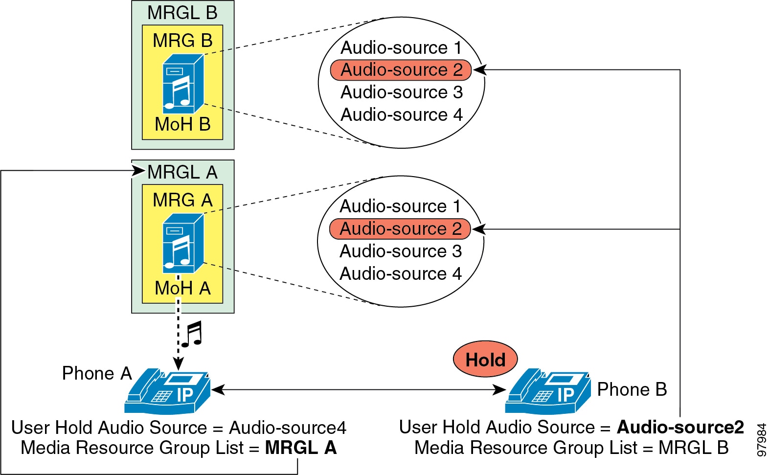

This section describes the MoH selection process as implemented in Unified CM.
The basic operation of MoH in a Cisco Unified Communications environment consists of a holder and a holdee. The holder is the endpoint user or network application placing a call on hold, and the holdee is the endpoint user or device placed on hold.
The MoH stream that an endpoint receives is determined by a combination of the User Hold MoH Audio Source of the device placing the endpoint on hold (holder) and the configured media resource group list (MRGL) of the endpoint placed on hold (holdee). The User Hold MoH Audio Source configured for the holder determines the audio file that will be streamed when the holder puts a call on hold, and the holdee's configured MRGL indicates the resource or server from which the holdee will receive the MoH stream.
As illustrated by the example in Figure 7-3, if phones A and B are on a call and phone B (holder) places phone A (holdee) on hold, phone A will hear the MoH audio source configured for phone B (Audio-source2). However, phone A will receive this MoH audio stream from the MRGL (resource or server) configured for phone A (MRGL A).
Figure 7-3 User Hold Audio Source and Media Resource Group List (MRGL)
