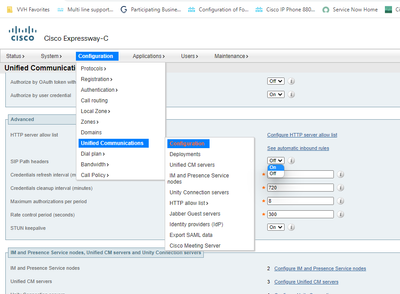

Is "SIP Path Headers"  enabled on Expressway-C under Configuration --> Unified Communications --> Advanced
Thanks Chris!  This fixed our problem, main number worked, others failed inbound/outbound but were configured correctly in CUCM.  Have 8841 phones with MRA 8.11.

Thank you this resolved the issue for me as well. The location was slightly different so I've attached a screen shot for others.
