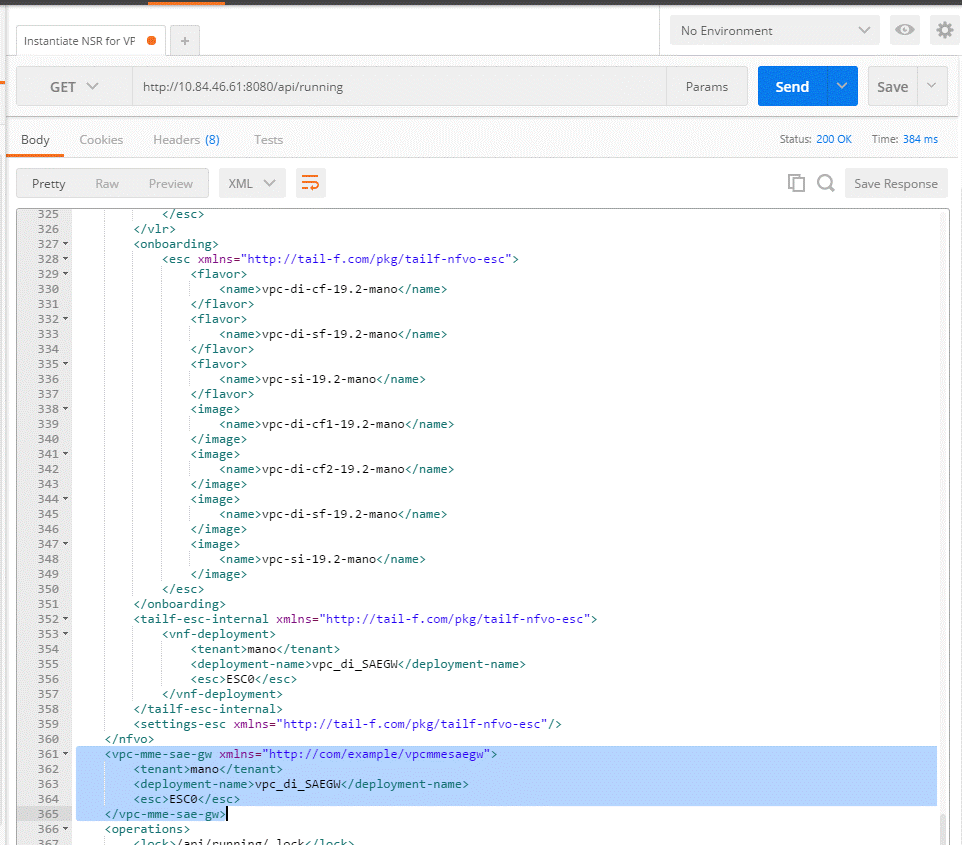

I did a GET on the api/running and see my service:
But when I try to delete that – it says “method not allowed”:

Hi Julie,
If we encode it all in the URL itself, does that work?
DELETE /api/running/vpc-mme-sae-gw/mano,vpc_di_SAEGW,ESC0
Thanks,
Bilal.

khgrant
Yes the following worked:
http://10.84.46.61:8080/api/running/vpc-mme-sae-gw/mano,vpc_di_SAEGW,ESC0
JA
