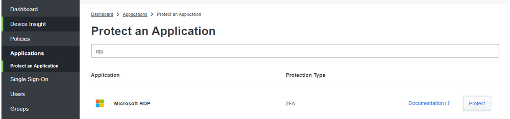

I should also probably include which application we are using DUO for (in case that’s a variable) - we are using DUO’s Microsoft RDP application to add MFA to user workstations. This is where we run into problems not having the phone option. (pic)
ubifcu
I opened a support case for this since it doesn’t look like we’re getting an answer here. Case 01154981. I’ll update this thread when I have more info.
Well, that was quick. Their exact reply:
“It looks like this was not enabled for your account, I have enabled this now and you should be able to allow the phone callback option via policy and authenticate to Duo using this method.”
I have verified it’s working now. Open up a support case and just cut and paste your forum post here (it’s what I did).
My guess: being that this is the first month that I’m on Duo, and was using a free account initially, the phone option was disabled because of that. I think if I waited until we got billed the first time, that option would have self-enabled.
