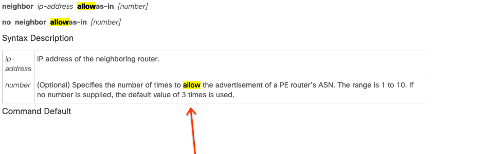

Hey John, could you post your config for CE1?
Might it be the case the allowas-in is working as intended and that the number of times (optional) the AS should be allowed in the as-path has not been statically configured?
If so, neighbor x.x.x.x allowas-in 4 should solve the issues here.
Hope this helps.
L.
Thanks I see it now. What about the override? Is it a correct behavior that all the offending AS are going to be replaced? Thanks!
John, yes, the as-override is working as intended, for details about the implementation I found this article.
Hope this helps.
Cheers, L.
