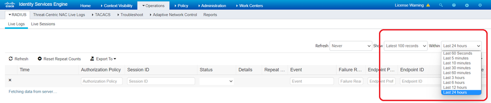

 Live Logs was designed to show the Latest 100 records, Within up to 24h:
 If you need more than 7 days you must use the Operations > Reports > Reports.
Hope this helps !!!

Hi @LovejitSingh130013 ,
Hope this helps !!!
