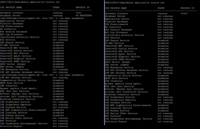

Unfortunately I have to confirm that post.
I got the same sh...t. Saw this post aftwards of course but it is Cisco...take a snapshot in advance meanwhile always...
FYI my Server was a fresh install of 3.4 with a restore of a 3.2 backup. The 3.4 NoPatch ISE worked in production the last 3 months.
  1. Patch via GUI failed, services don't come up after reload (see screenshots before you ask questions)
  2. Patch via CLI failed, services don't come up after reload (see screenshots before you ask questions)
Result: Revert to Snapshot without Patch.
