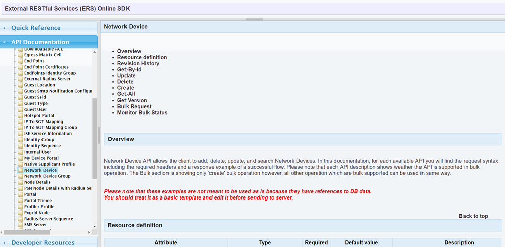

You can use the Cisco ISE ERS API create, delete, search, and modify Network Devices and Network Device Groups.
More information on how to use the API can be found here: https://community.cisco.com/t5/security-documents/ise-ers-api-examples/ta-p/362262
The Network-Node blog has some examples of REST-API calls to create Network Devices and Network Device Groups. http://www.network-node.com/blog/2016/4/19/ise-rest-api-goodbye-click-click-click-click-part-2

Take a look at this ERS documentation available from within ISE. The operations are well documented in both XML and JSON.
I would recommend also checking out http://cs.co/ise-api
