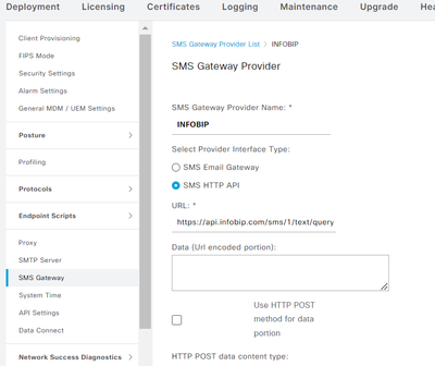

In my case, the SMS gateway is INFOBIP. I am sending the parameters on ISE as follows:
https://api.infobip.com/sms/1/text/query?username=<USERNAME>&password=<PASSWORD>&to=$mobilenumber$&text=$message$
Note: Replace username and password with the ones you registered with the provider.

We are implementing the infobip as a sms provider in ise 3.2
We used that parameter posted above by rafaelsalvinos:
however it is not working, ISE could not send sms messages. We tried those parameters on postman as well to validate the url, but same result
We have checked the infobip documentation, it seems like the parameter (https://api.infobip.com/sms/1/text/query?username=<USERNAME>&password=<PASSWORD>&to=$mobilenumber$&text=$message$) was deprecated , as checked on the provider documentation from the link below:

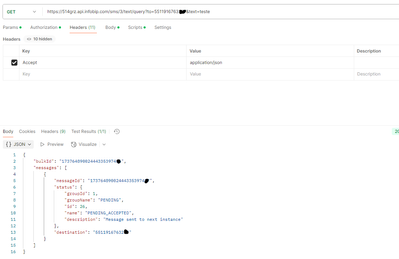

We have tried the parameters from API v3 from infobip
exemple from the site:
curl -L 'https://514grz.api.infobip.com/sms/3/text/query?from=InfoSMS&to=41793026727%2C41793026834&text=Message%20text&flash=true&transliteration=TURKISH&languageCode=TR&intermediateReport=true&notifyUrl=https%3A%2F%2Fwww.example.com&notifyContentType=applica...' \
-H 'Authorization: {authorization}' \
-H 'Accept: application/json'
We have got this working on postman using the API key (instead of using user and password from API v1)
Postman successful test below:
But on ISE it is not sending the sms message, probably we are not putting the parameters correctly on ISE configuration or it has compatibility issues with infobip api v3.
Has anyone configured infobip api v3 on ISE? please share the correct configuration on ISE "SMS Gateway Provider"
