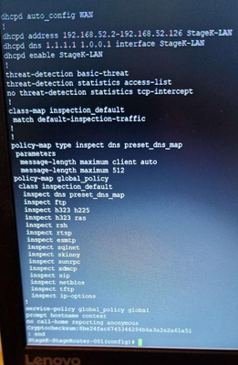

I have an Cisco ASA5505 that i have just been using as an simple stage router for providing DHCP.  But in the current state i need to have it running thr anouther router hooked to a switch.  The Cisco router And my main router is in their own VLAN on the switch.
I dont get internet on what i have connected to my ASA.  And i think it has to do with my NAT
so i tried to do "Access-list 100 permit ip 192.168.50.239 255.255.255.0"  wich is the static ip my main router has given my ASA
but when i try to execute it it just retuns with "IP Adress, Mask <192.168.50.239, 255.255.255.0> doesn't pair"
And it dossent fully make sense in my head since it took an /24 subnet just fine when i sat up my VLANs
Here is my config btw

well i found out why,  I gave it 192.168.52.0 then it accepted /24 subnet.  but i cant compleete the setup cuz the thread i was folowing was for verison 15.2 and im on 8.4
the content of the screenshots is not visible. Post the running configurations in a text file. Also, post a diagram of your topology showing how your devices are connected to each other.

Hi there,
squinting at those screenshots, you are certainly missing a default route:
route WAN 0 0 192.168.50.xx
...replace xx with the routers interface IP which is connected the ASA.
