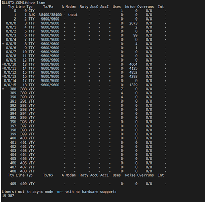

ok, so i ran the commands that you posted and this is how my lines look.
What would be the command to check if I can console into the other switches from this console server(router).
Let me know if I need to make any changes
From the image you provided, I can see that your async interfaces range is 0/0/0 through 0/0/15 and those correspond to lines 3 through 18.
So first async interface, async 0/0/0, corresponds to line 3. If you connect this line to a console port of another device you want to manage and issue the following command from the terminal server:
telnet <any IP on the router> 2003
you will access the other device console port.
On the vty lines, don't forget the transport input telnet ssh command in order to be able to access the router via telnet/ssh.
