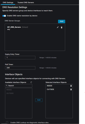

I have a FMC and HA FTD on HA mode version 7.3.1for both. The DNs server is connected via INSIDE interface only. The Firepower can ping the DNS server as shown below, but the DNS is failed. I configured the DNS and domainsearch. The DNS is not resolving through the INSIDE or OUTSIDE interfaces. The DNS is only resolving through the management interface when I use  "ping system xxx" command. I believe there is something else I'm missing. Please can you check and let me know what you think.

Did you get an answer on this? I am experiencing a similar if not the same thing. I had DNS servers configured on the inside interface that were working without issue. I upgraded FMC only to 7.4.2 and now DNS resolution doesn't work on the FTDs. I checked the running-config and it wiped the DNS servers I had configured off the inside interface. I checked FMC, and my DNS Server Group is still configured with IPs and that group is configured in Platform Settings... So... it's configured, but not configured. I open a case with TAC but still waiting to hear back. Just wondering if you had any progress.

You're issue may or may not be the same as mine, but I ultimately fixed it, so I figured I'd post my fix in case anyone else finds this post with a similar situation. FMC was showing my DNS Server Group as good. My DNS Settings in Platform Settings as good. But DNS wasn't resolving. I checked the running-config via diagnostic CLI and noticed that, even the DNS was configured in FMC and supposed deployed, the config was NOT on the FTDs. I first tried removing a DNS server from the group, to initiate a change, but FMC did not see any changes to deploy. I then deleted the DNS Server Group in DNS Platform Settings and simply re-added it. I was then able to deploy the DNS settings, which then appear in the running-config.
