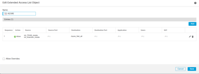

Why would you need to use the access lists instead of the subnets? I'm not a 100% sure about why using the access lists as the protected networks didn't work for you, but looking at the following link I understand that using the access lists should be done on both sides which doesn't seem to be the case here. Also, could you please share how you created that access list for review?
"You must configure all nodes in a topology with either crypto ACL or a protected network. You cannot configure a topology with crypto ACL on one node and protected network on another."

Here is a basic "Extended Access List" Ports follow when I get a connection over this
oh sorry forget somethings
I tend to disagree on this :). The crypto ACLs wouldn't be intended to filter the VPN traffic. My recommendation would be configuring the tunnels with the subnets as you've already done and then apply VPN-Filter to restrict what traffic you want to allow on the tunnel. The VPN-Filter uses extended access lists, so you can narrow down the accesses as you wish. If I remember correctly when you create the VPN-Filter ACL you put the remote subnet in the source and the local subnet in the destination, kinda you flip them around. Another thing to keep in mind with the VPN-Filter is that when you add a deny statement while the tunnel is up it will immediately take effect, however, when you permit something while the tunnel is up it won't, so in that case you need to reset the tunnel before the newly added permit entries take effect.
