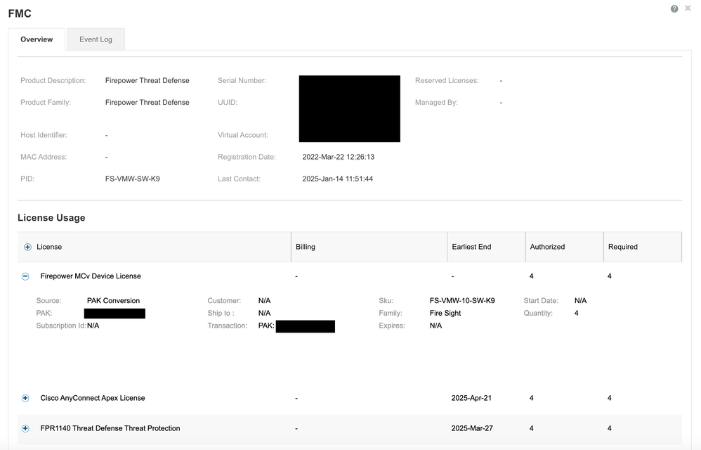

Thank you for the information! Regarding option 2... if it's a perpetual license, how does the new license "take over," considering the old one never expires? I see them both in SmartLicensing but the PID of FMC in SmartLicensing still shows FS-VMW-10-SW-K9.

Can you share a sanitized screen shot of your Smart Account license inventory showing both items?
Here are two screenshots. The one shows the new license being added 1/14/25 along with the old one. The other image shows the FMC (in SmartLicensing, not on the actual FMC appliance) showing that only the old PID is being used. Thanks!
Screenshot 2025-01-30 at 8.15.16 AM.pngScreenshot 2025-01-30 at 8.15.38 AM.png
I would try to unregister and then reregister the FMC to Smart Licensing and confirm if it picks up the correct association.
If that fails, perhaps you could move the old license to a different Virtual Account to prevent it from being used. Then try to reregister the FMC using a token from the correct virtual account.
