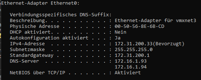

The server has the following IP configuration:
NSLOOKUP ends with each request in a timeout:
