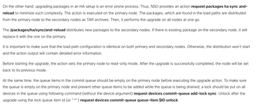

You can use the following command
request packages ha sync and-reload
See this excerpt from the NSO admin guides. Some caveats are that the commit queue is empty before running and locked. This essentially sets the primary node to read only and sync packages from the primary load-dir to the slave.
Scroll down to the Package Upgrade section and find the relevant HA information. It even has a script example if you want to build upon that and use it.
https://developer.cisco.com/docs/nso/guides/#!nso-deployment/upgrading:~:text=mix%20them%20up.-,Package%20upgrade,-Package%20upgrades%20are
