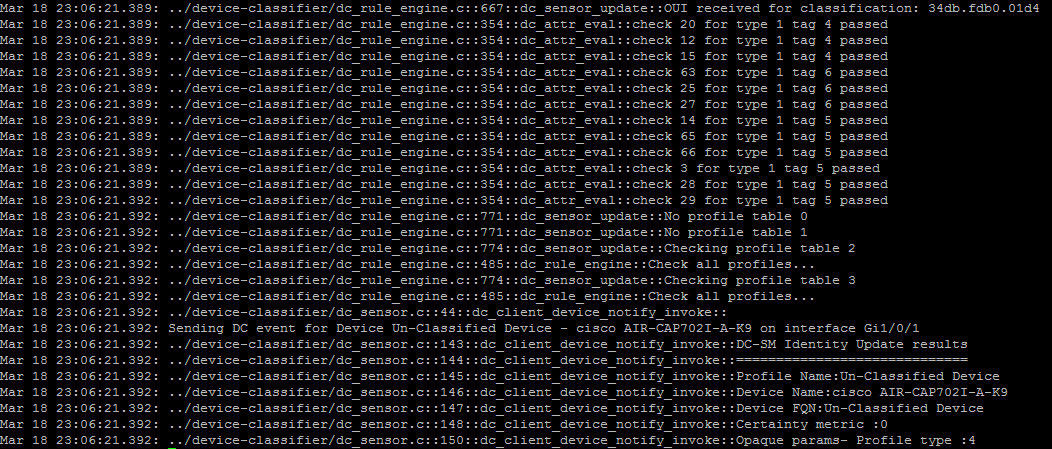

Here is a CAP702i:

  1. Is there a way (besides updating the firmware) to add to the known devices list?  "sh macro auto monitor"
    I've considered adding all of the OUIs, there are about 6 that I've found.  Is that my best solution?
  2. If I start filling the switch up with OUIs to detect, am I going to have a performance hit?
