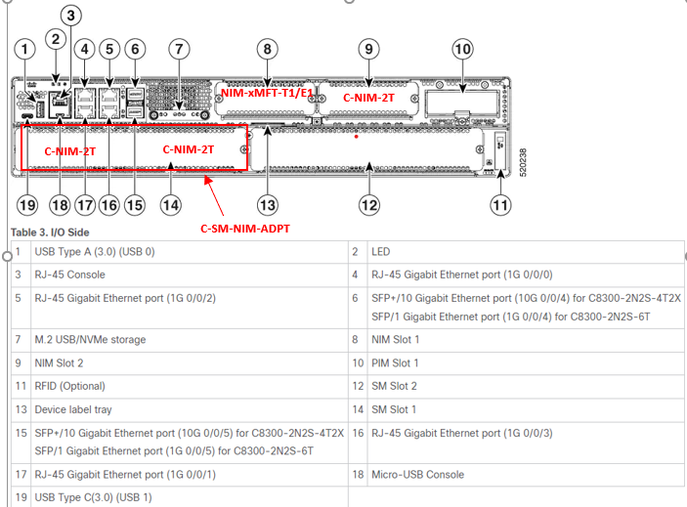

Hello everyone,
I am searching for the "port numbering" of a C8300 Router, when I use NIM´s like in the picture below.
For example the 6 intergrated ports have the numbers (1G 0/0/0) to (1G 0/0/5)
But what about the ports on the NIM´s?
Thanks in advance!

In general most Cisco device follow same standards
if you install slot 1 depends on module, take example if you install switch module
it will be 1/0/X
if you install slot 2
it will be 2/0/X
you can see example installting  C-SM-16P4M2X
https://www.cisco.com/c/en/us/td/docs/routers/cloud_edge/c8300/Interface_Module_SCG/C-SMX16G4M2X-book.html
BB
And if I use the first slot on SM Slot 1 (see image above) it would be 1/1/x ?
Dont have device in hand i am going with document, i am sure number is not an issue as long as card detected and it show you what port numbers ? is the number is concern here ?
