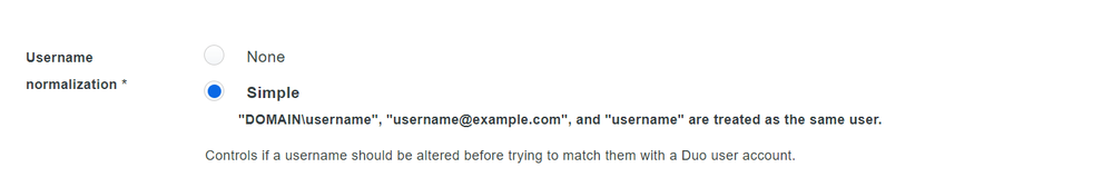

Not sure if you’re still interested in a solution, but there is one that I’ve applied and is confirmed working with the LDAP Groups. Frighteningly enough, the solution is quite simple:
  1. In Username Attributes of the application (Palo Alto GlobalProtect - Single Sign-On), enable “Custom Attributes” and change the Username Attribute from to msDS-PrincipalName.
  2. Make sure “Username normalization” is set to simple.
  3. On the Palo: Device > Authentication Profile: Username Attribute should still be User.Username (Case sensitive - both "U"s NEED to be upper-case, or the login will default to user@domain.com:
That’s really it - Worked like a charm.
The only real major change was the Username attribute change to msDS-PrincipalName.
