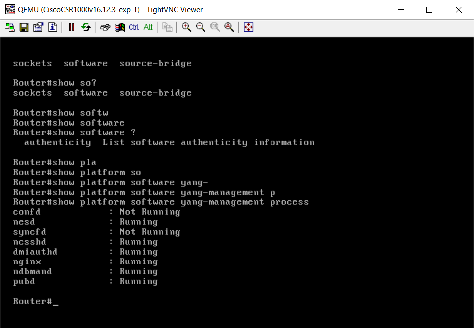

I am using CSR1000v (IOS XE 16.12.3) in GNS3 and I have issues while trying to enable streaming telemetry.
I have followed page: Programmability Configuration Guide, Cisco IOS XE Gibraltar 16.12.x
First issue that I am facing is that the output of command
show platform software yang-management process
is not as expected. In my case two processes are not started (confd and syncfd):
Anyway, I have continued to follow the process described on the page. When I finished setting up streaming telemetry (as described on the page) I checked output of the command:
