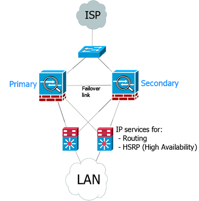

So I've been thinking of replacing the router with two layer 3 switches for redundancy and future-proofness:

Now my question is, if i configure these switch ports as routed ports they cannot belong to the same network, correct?
I would have to configure a single VLAN 1 on the switch for the 10.1.0.0/16 subnet but would i also have to tag the ports as belonging in VLAN1 or simply add a default route to the firewall's interface? How would this work? If all ports are switch ports and the VLAN is in the 10.1.0.0/16 subnet then i would only need to add a single static route to send remotepool traffic out to the ASA's inside interface?
These LAN connections would be connecting to a HPE switch stack so RSTP would also be needed.
Which makes me think, is it worth using the ASAs as the default gateway instead for now to simplify things and look to buy layer 3 switches only if we decide to split the network into VLANs? The userbase is somewhere between 100-150 users.
In which case, is there anything i should be aware of when using the ASA as the network's default gateway? I assume the ASA would not need any additional routing done to connect the inside interface 10.1.0.x/16 to the remotepool clients.

you don’t really need to use hrsp depending switch type you can just use say  two stackable 2960x for example in a stack with a default route pointing to the asa HA
I am assuming the Asa’s are HA failover and as such just have each individual asa inside interfaces (and outside if applicable -in different L2 vlan access ports) attach to either one of the physical switches in this stack - HA failover will do the rest.
