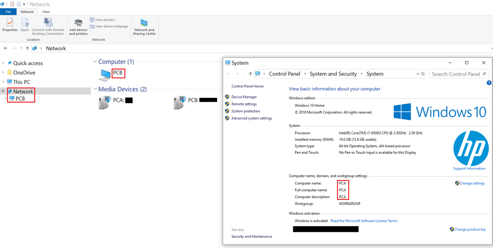

when I connect both pcs to my Catalyst 2960 switch, PCB automatically appears under the network tab in PCA and vice versa
as you can see in the attached photo.
I can double click on PCB and drag and drop files between the two desktops directly.
when I connect both pcs to my Cisco 2800 router and assign IP addresses according to the topology above, I can ping between the pcs but can’t share files!
How can I share files between two pcs on different networks as if they were connected to the same switch?
