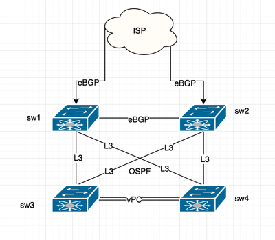

I have following scenario where my ISP gave me two link primary and secondary (for redendency and ISP sending *Default Route* on eBGP) and i have terminated on my L3 switch where i am planning to run BGP but i have question related what i should run between "sw1" and "sw2"?   iBGP or OSFP ?
Note: by mistake i mentioned eBGP between sw1 and sw2 but its actually iBGP (it was typo)

The SW1-to-SW2 link should only run iBGP. SW1 and SW2 will be redistributing eBGP routes into OSPF (not iBGP routes). If there is a failure on one ISP connection, the other edge device will learn all BGP routes from the other edge device. The edge device that lost the ISP connection will also stop redistributing all BGP routes as the only BGP learned routes will be internal. Because SW3 and SW4 are connected to both routers, they will learn all routes only from the OSPF connection to the edge device which still has an ISP connection.
You are suggesting to run iBGP between sw1 and sw2 point-to-point link and all other internal L3 interface should run OSFP right?
That is correct.
