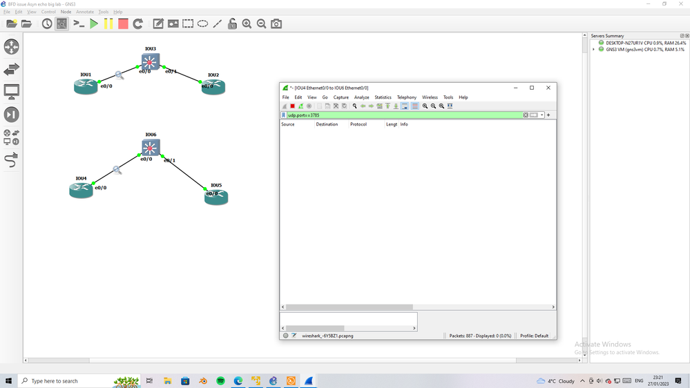

Case1:- both router run BFD and as I mention above BFD echo is also run by default if we enable BFD under interface.
the BFD echo if not receive from neighbour it will down the BGP.

to capture the traffic of BFD echo, do
udp.port==3785 <<-filter in wireshark
