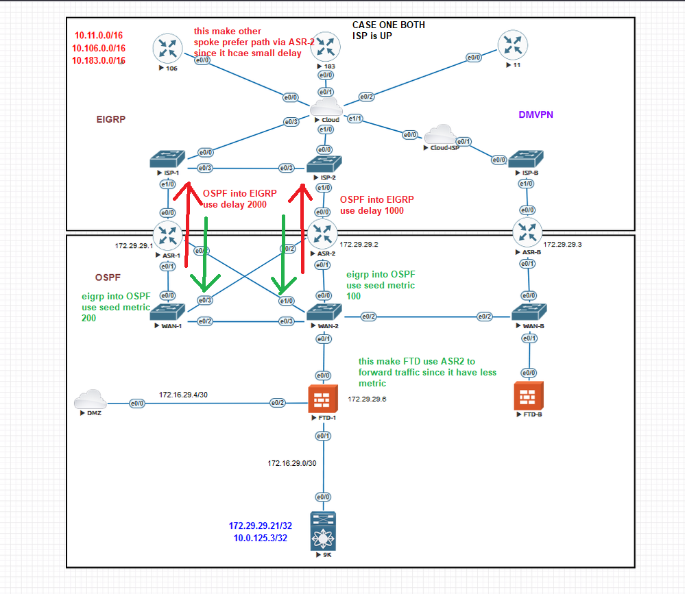

hi every one,
i have this topology and it works good but i face issue with it.
the topology is attached in below.
the upper side running  DMVPN with EIGRP
ASR-1,ASR-2-ASR-B are the hubs
routers (106,183,11) are the Spokes
and the lower side running OSPF .
Redistribution is running between OSPF and EIGRP.
ASR-1 is primary for DMVPN and OSPF Routes ,ASR-2 is second and ASR-B is Third
the ping is work fine form 10.11.0.0/16 to 172.29.29.21 and opposite as well thru ASR-1
when i try to test if Shutdown ASR-1 Traffic  automatically changed to ASR-2 and it work good.
the problem is when i shutdown the ISP-1, DMVPN Spokes disconnect form ASR-1 and change to ASR-2 and when i try to ping
from  172.29.29.21(9K) to 10.11.0.0/16 (Spoke) send the packet to ASR-1 , But ASR-1 didn't no the way to 10.11.0.0/16 becouse the DMVPN down ASR-1 with all Spokes.
Verfication:

thanks for replying
the problem is on the FTD-1 i prefer the path to ASR-1, and because ISP-1 SW is Shutdown ASR-1 cannot learned eigrp router from spokes so 172.29.29.21(9K) Cannot reach  10.11.0.0/16 (Spoke)
i fixed it by matching routes on FTD-1 coming from ASR-1,ASR-2 and ASR-B and set metric to each one .
  Glad you fixed it, however, there might me something lurking there in your configs and might run into problems down the road. I'm saying this as once ISP-1 is down, ASR-1 EIGRP adjacency should go down, so ASR-1 should no longer have any EIGRP routes in RIB, thus no longer redistribute EIGRP routes into OSPF. So how come FTD was routing via OSPF through ASR-1, it doesn't make sense.
  Plus, when you have multiple redistribution points, without proper route-control, you'll end up into temporar or permanent routing loops when certain events happen, situation called race condition.
Best,
Cristian.
FTD-1 is receiving Routes form ASR-1,ASR-2 and ASR-B, i set ospf cost on FTD-1 to prefer ASR-1.
as you say, once ISP-1 is down, ASR-1 EIGRP adjacency is down so ASR-1 should no longer have any EIGRP routes in RIB, thus no longer redistribute EIGRP routes into OSPF.
the issue is when i ping form spoke router to any network in the 9K networks like 172.29.29.21 the ping not working because the traffic when it  reaches to FTD-1 via ASR-2 (ASR-1 not have any EIGRP routes from spokes),
the FTD-1 send traffic back to ASR-1(preferred path) because of that the traffic getting dropped .
so i solved the problem by tagging the traffic from each ASR and match the tag on the FTD-1 and set cost to each one by preferring
ASR-1 , so when ISP-1 goes down ASR-1 will no longer send routes to FTD-1 .
in this case FTD-1 will select routes from ASR-2.
hopefully it does make sense for you.
thanks again for your interest.
this if both ISP is UP instead of using cost use metric when you redistribute the OSPF into EIGRP
and use delay when you redistribute the EIGRP into OSPF.
