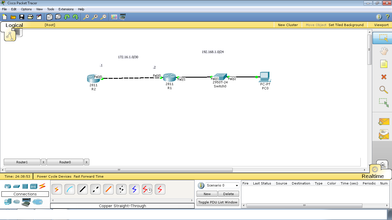

Hi there I'm reviewing my ccna topics so I created a Lab to refresh my memory.: If the purpose of network command is to 1.) advertise the network covered in network command 2.)send routing protocol(rip) updates to the interface covered in network command.
So here's my problem .If I issue R1#debug ip rip
          R1#RIP: sending  v2 update to 224.0.0.9 via FastEthernet0/0 (172.16.1.2)
          RIP: build update entries
                192.168.1.0/24 via 0.0.0.0, metric 1, tag 0
as you can see R1 does not advertise the 172.16.1.0/24 to the fa0/0 interface. My question is why does it not advertise the 172.16.1.0/24 to the
fa0/0? I did not configured rip to R2 cause it will enable split horizon of R1 due to the fact R2 will advertise the 172.16.1.0/24. Both interface of R1 is in up/up status. I can't recall the reason why can you pls enlighten me. Pls don't tell me that its split horizon issue. Thank you

Thanks Tyler for the reply. I intentionally put passive interface on R1 fa0/1 cause it's connected to Lan network and no need to send and receive advertisement. Now I've recalled it has something to do with split horizon. And the reason why R1 does not send the 172.16.1.0 to fa0/0 cause it's connected through it. Which means connected routes are also learned which has administrative distance of 0. Thanks
"I did not configured rip to R2 cause it will enable split horizon of R1 due to the fact R2 will advertise the 172.16.1.0/24"
Sorry for this quote this is wrong. If I enable rip on R2 with the network 172.16.0.0 command, R2 will not advertise the 172.16.1.0 to R1 cause split horizon will take effect. R2 is connected to 172.16.1.0, just what I said in the previous post that connected routes are also learned. Thanks
You answered your own question really.  Why would RIP advertise the 172.16.1.0 network out of that interface if its a connected interface (i.e. it has learned of that network in its own connected interface list)
Split horizon says don't advertise a network out of the same link you received it on, in this case we received 172.16.1.0/30 on Fa0/0 so we aren't going to advertise it out of that link!
Also, why would R2 need to know about the 172.16.1.0/30 network when it already has a connected interface.
Enabling RIP on FA0/0 of R2 will not cause an issue, it will just receive the 192.168.1.0/24 routes from R1 and do exactly the same as R1 (i.e. not advertise the 172.16.1.0/30 network out of FA0/0!
"Pls don't tell me that its split horizon issue."
Does this explain anything or are you after a different answer?
Simon
Thanks for the reply brooks just what I said in the previous post I'm trying to recall. so please bare with me.But anyway sorry for the inconvenience I've brought to you. Thanks
