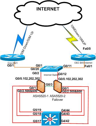

Slow Internet Upload Speed in ASA Cluster
I have 2 ASA5520 devices running in a Active / Failover state.
ASA5520_Primary:  Cisco Adaptive Security Appliance Software Version 8.2(4)
ASA5520_Fail:  Cisco Adaptive Security Appliance Software Version 8.2(4)
Internet Connection:  50M DOWN / 50M UP - Fiber
When I make the ASA5520_Primary or (ASA5520-1) as the Active ASA, I get Upload Speeds that appear to be extremely slow.
When I make the ASA5520_Fail or (ASS5520-2) as the Active ASA, my speeds are more than doubled.
I have tried making static 1000/Full on ports from ASAs to InetSwitch but doesn't make a difference.  I have swapped cables, so I know port level configs are fine due to speeds follow the cable to opposite ports.  Port level configs are at the bottom.
Is there something on the Primary Config that could be causing this?
This is the topolgy of the internet Connections.
