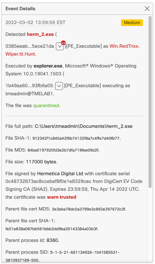

Now, most of the damage done in the previous description can be traced to a single failure: that unsuccessful quarantine of the original malware, blocked by our guard rail mechanism. Since we clearly should no longer trust a certificate that was used to sign a malicious file, let’s see what happens under the same set of circumstances, but with updated information so we know that the certificate has been compromised or otherwise abused.
Here is what the initial detection event looks like now:
So, now that the signing certificate is no longer fully trusted, the guard rails no longer apply, and therefore the quarantine attempt succeeds, thereby stopping the attack in its tracks.

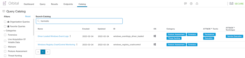

The Orbital advanced search service that is available to Secure Endpoint customers at the Advantage license tier and higher is helpful here.  Searching the catalog of prebuilt queries for “hermetic” shows two useful items.
The first, labeled “windows_eventlogs_driver_loaded”, is well suited to hunting for signs in the event logs of other driver-dropping events similar to what was described above.  Also, because the attackers are known to disable crash dumps in order to interfere with forensic analysis, the “windows_registry_crashcontrol” query can be used to find other endpoints that show signs of this technique.
