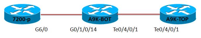

Topology used for this example and verification:
When “7200” is sending cdp to the ASR9000 and ... :
Scenarios:
1) the 9k "BOT" has cdp enabled on its main interface then you’ll establish a cdp relation between “7200” and “9k-BOT”. No untagged EFP defined on the respective interfaces.
2) the 9k BOT does not have cdp enabled on its main interface AND you have an untagged EFP defined on the 9k which is put in a xconnect for instance connecting g0/1/0/14 to te 0/4/0/1 on ASR9K-BOT, THEN “7200” will establish a cdp relationship with “ASR9K-TOP”: the CDP packets are transported over the XCON.

ASR9K-BOT configuration:
EFP to transport the untagged packets to the ASR9K-TOP
interface TenGigE0/4/0/1.1 l2transport
encapsulation untagged
To capture the CDP packets on to an EFP define this:
interface GigabitEthernet0/1/0/14.1 l2transport
Main interface configuration facing the 7200. The "cdp" keyword here is present depending on the test cases above.
cdp
load-interval 30
Cross connect configuration
l2vpn
xconnect group cdp
  p2p cdp
ASR9K-TOP configuration:
cdp
