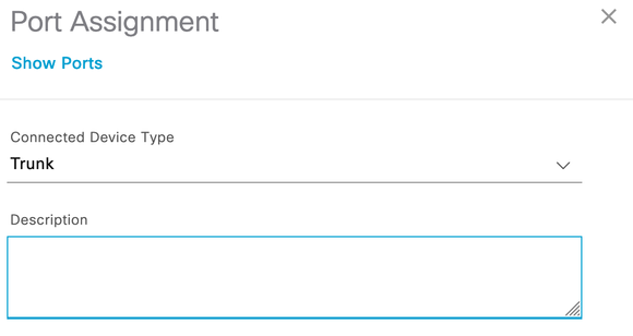

yes it is possible. In DNAC you configure your connected device type as trunk. create the vlans on the extended switch. Then configure your ports for the hosts to connect.
