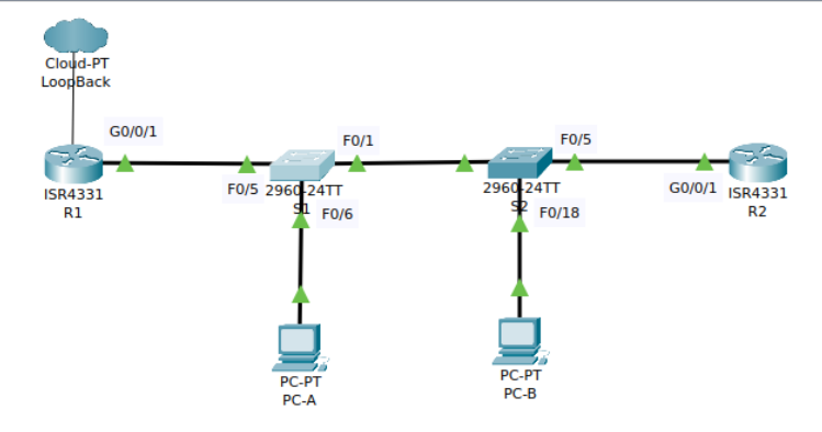

Hey,
I am currently working on a ccna prep lab which is supposed to be on ACLs.
But I am having errors setting up the basic topology.
I have redone the lab from scratch several times now, and I cannot determine the main issue; which is PC-B cannot connect to anything. Everything else has total inter-connectivity.
Something that may be helpful:

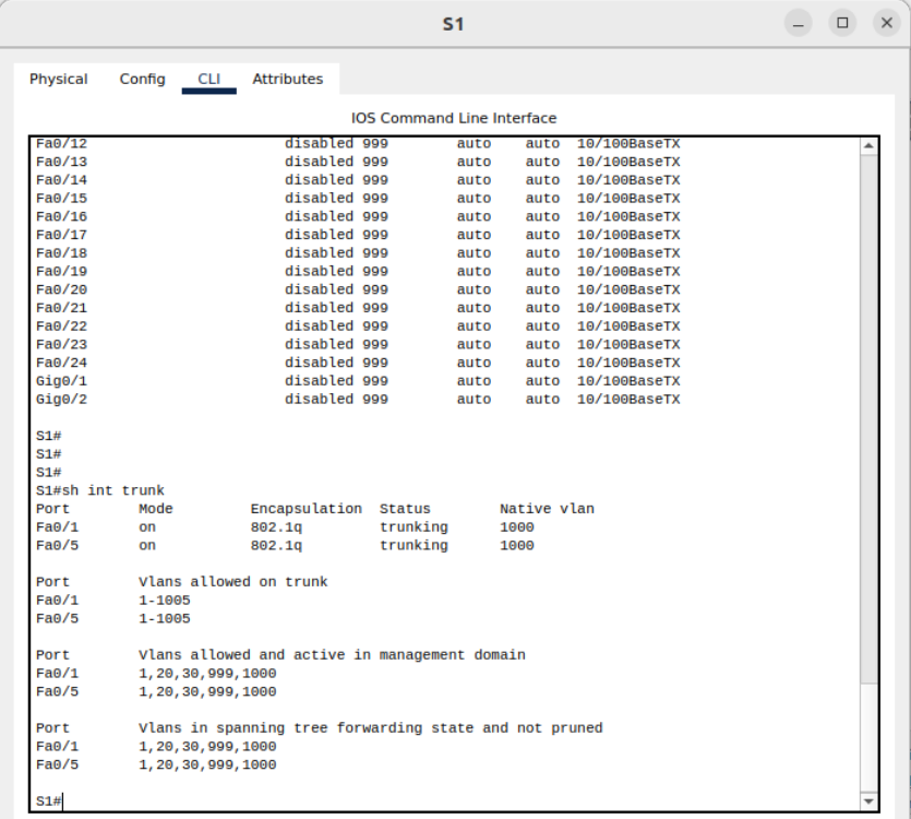

PC-B in VLAN 40, connected to Switch 2, I notice that the vlan is down. But the port is up (pc -> sw2). If I turn the vlan 'on', no difference. When I shut it back down, move the PC-B port to another sw2 port, enable the port, and assign to vlan40, still nothing. Which from my understanding the vlan should come up if there is a device plugged in. I try anyway to manually bring the vlan40 up, but still nothing in or out of PC-B.
I have checked all interface ports, VLANs, changed the VLANs allowed on trunks. Nada.
Any assistance, and troubleshooting advice would be greatly appreciated.
Thanks,
Mitch
 My Topology:

@mitchie
Switch 2 will not ping PC2 as It doesnt have IP address on vlan 40. It Will ping host on vlan 20.
 If PC2 is able to ping 10.40.0.1 but nothing else, then the PC2 does not have default-gateway configured.
If PC2 can not ping 10.40.0.1, you may have layer2 problem and traffic is not making It from switch 2 to router
4 Replies 4
Because R1 is doing the inter-vlan routing, vlan 40 must reach the R1. From the config of switch1 it appears that vlan 40 is not defined on switch1.
Configure it on switch1 with the following commands:
conf t
vlan 40
You should have connectivity after that if R1 is configured correctly.
HTH
Regards, LG

mitchie
@Flavio MirandaThanks for taking the time, appreciate it.
I added another device and attached it to the other vlans connected to Switch2, and they worked.
That narrowed it down to do vlan 40, f0/18, and as per @liviu.gheorghe suggest: R1's g0/0/1.40
Ashamed to say, that it would appear that the issue was that PC2's IP was set to 10.40.0.1 and not 10.40.0.10
I've spent way more time than I would like to admit over the past couple days working on this. Good re-fresher I guess.
