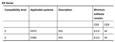

Hi @b.winter
Thank you for the response. I had gone through the Release Notes and could find only the below regarding the firmware.
But the compatibility level from the end point by going through Setup > Status > shows the compatibility level as 1.
Can you advise?
Thanks and regards,
Libin Benedict
11-10-2022 03:36 PM
I was able to upgrade directly from 9.1.6 to the latest CE9.15.15.4.
