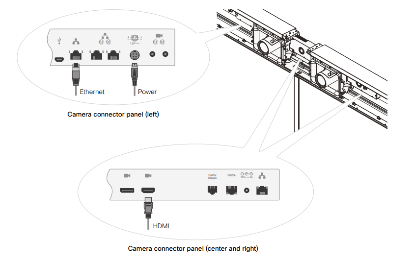

Make sure the cables for the camera (HDMI and control cable) are connected properly. Loose connection would be the cause. Try to reset the camera cable connections on the codec and also on the camera modules.
After resetting cable connections, try to reboot the system.
After reboot, access the web interface and log on on the system then run troubleshooting:
Diagnostics > Troubleshooting > Re-run diagnostics
You should not get any error regarding camera connections.
Then check camera speaker track mode if enabled:
Configuration > System Configuration > Camera Settings > Cameras SpeakerTrack Mode: Auto
If set to Off you will not get the speaker tracking option on the touchpad.

Based on the screenshot, there might be problem on your cabling with the cameras. Check the connection of the camera cables as per the guide attached by Wayne. check also the PoE injector if it is powered and the camera should be supplied with power for the codec to detect it.
Also there's an error regarding H323 Gatekeeper registration but this problem have no connection regarding your camera issue. You should check this error as well.
Try also to do factory reset on the system. Refer to page 146 on this guide.

Have you verified all camera cables are connected per the installation guides, making sure the ethernet cable from the camera is plugged into the correct port?
MX700 Dual Camera Floor Stand Installation Sheet
MX700 Single Camera Floor Stand Installation Sheet

Make sure that the Ethernet cables to the cameras are connected correctly (and to the correct cameras) as per page 16 of the Installation Sheet.  Also make sure that the PoE module is correctly connected - Page 14.
