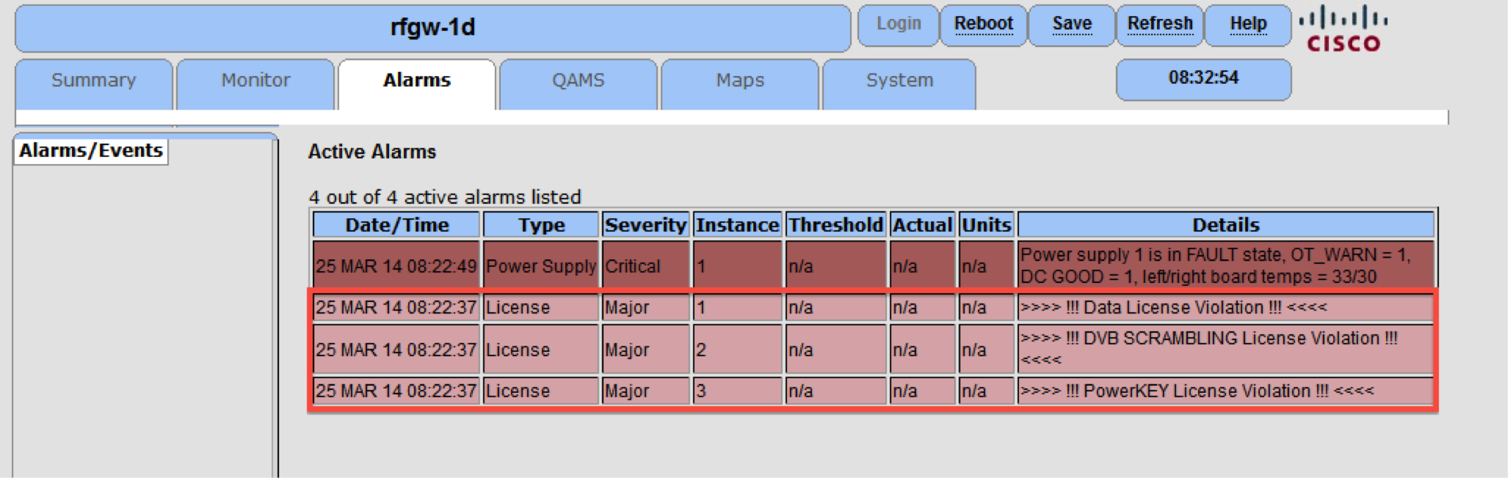

The problem is characterized by the following behaviour:
Under the RFGW1 GUI alarm tab, we are seeing a “License Violation” active alarm as per the following screenshot:
This license violation alarm does not impact the performance of the unit, all services are running fine.
