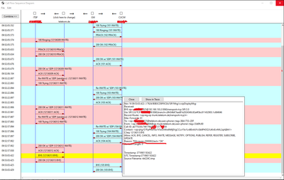

I made again a test call and collected gateway logs. I see in the logs that we get the BYE from the provider.
