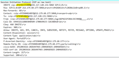

I am facing a problem with sip provider connect direct to the cucm (this is new topology we test )
the request URI Header in the INVITE massage is the main registration  number +972765321800 instead the DID +972765014007
for example
 incoming call to +972765014007
INVITE sip:+972765321800@192.117.120.131:5060 SIP/2.0
the cucm try to collect the number from the request URI field and this is way I cant route the number +972765014007 to extension
the right  number found in the "TO:" header
"To: < sip:+972765014007@192.117.120.131:5060> "you can see in the image
as i know the only way i can fix it is with sip normalization
i need normalization script
the first parameter is always orignumber = "+972765321800"
this parameter need to replace with this parameter  didnumber =  "+972xxxxxxxxx"
in the end i need to modify the request URI Header and change the parameter from orignumber to  didnumber
the new invite massage after the normalization script >>  INVITE sip:+972xxxxxxxxx@192.117.120.131:5060 SIP/2.0
